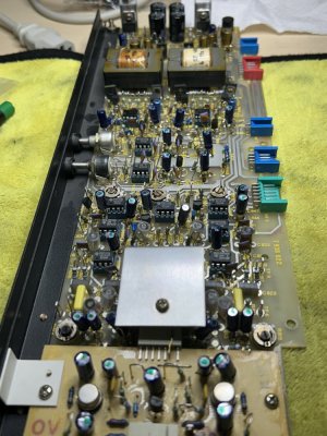

Your advice completely makes sense! I was super inpatient and earlier took out the audio board and replaced all tantalums.
This gave some positive results. I have the left channel now. Unfortunately no right channel at the headphones.

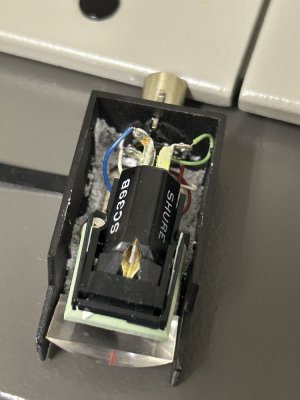

Why I say your comment makes sense is because when I looked at the cartridge things do not look very well.
I believe this is some kind of rust on the inside. Further more the sound from the left channel is not very good.

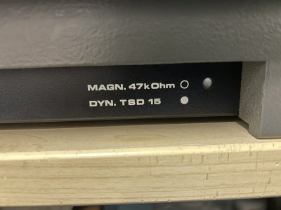

In this respect, I have another question: may I use a MM cartridge for testing purposes? If I understand correctly the service manual I should be able to use one if I remove the additional board (the pre pre amp was it called?).
This is what I have
This is what I have
