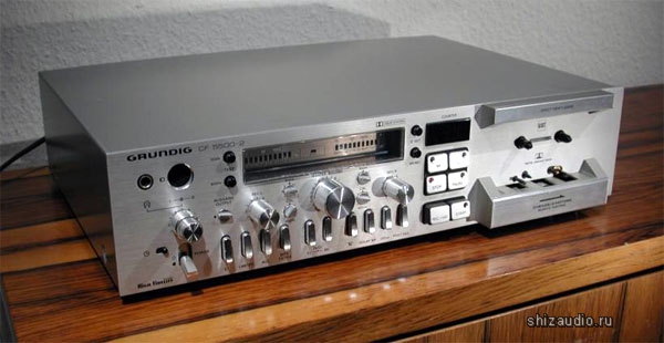

From my experience, I have got a perfect replication (to my ears) of the source, while recording only on 2 machines I have come across. My NAK DR3 and a high end Grundig CF5500-2, 3-head deck.
Here is a pics of my NAK DR3 and the Grundig deck which I have referred to:
