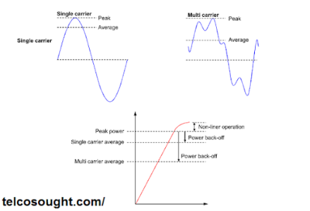

I have shared some calculations. I hope it will be useful for some.
Simplified definitions:
- Prms is output voltage x output current when amplifier output is a single frequency. Say: 1kHz.
- Pave, as applied to audio application, is ave of output voltages of different frequencies and different amplitudes x ave of output currents of different frequencies and different amplitudes
- Peak power is a measure of an amplifier to handle very large power for a very very small amount of time or an instance of time.
- Kindly note that considerations such as crest factor of 3 used for audio application, signal processing such as compression can skew the interpretation of calculations or the definitions
RMS Power vs. Average Power​
Question:​
Should I use units of root mean square (rms) power to specify or describe the ac power associated with my signal, system, or device?
Answer:​
It depends on how you define rms power.
You do not want to calculate the rms value of the ac power waveform. This produces a result that is not physically meaningful.
You do use the rms values of voltage and/or current to calculate average power, which does produce meaningful results.
Within its specs limits, it doesn't matter to an amplifier, whether the input signal is a complex musical piece or a sine wave test signal
The average power (Pavg) of a sine wave is the time-averaged value of instantaneous power over one full cycle. It represents the constant DC component of AC power, often termed active or real power. For a purely sinusoidal load, it equals half the maximum or peak power
For a pure sine wave, the Average Power is exactly half of the Peak Power
Attch shows Sine wave vs music signal, pls note that the value of average power is closer to peak power in a sine wave .
That's why during sine wave testing , volume should be kept low
For more detailed information, please read the application notes by Rane Audio & Audio Precision
