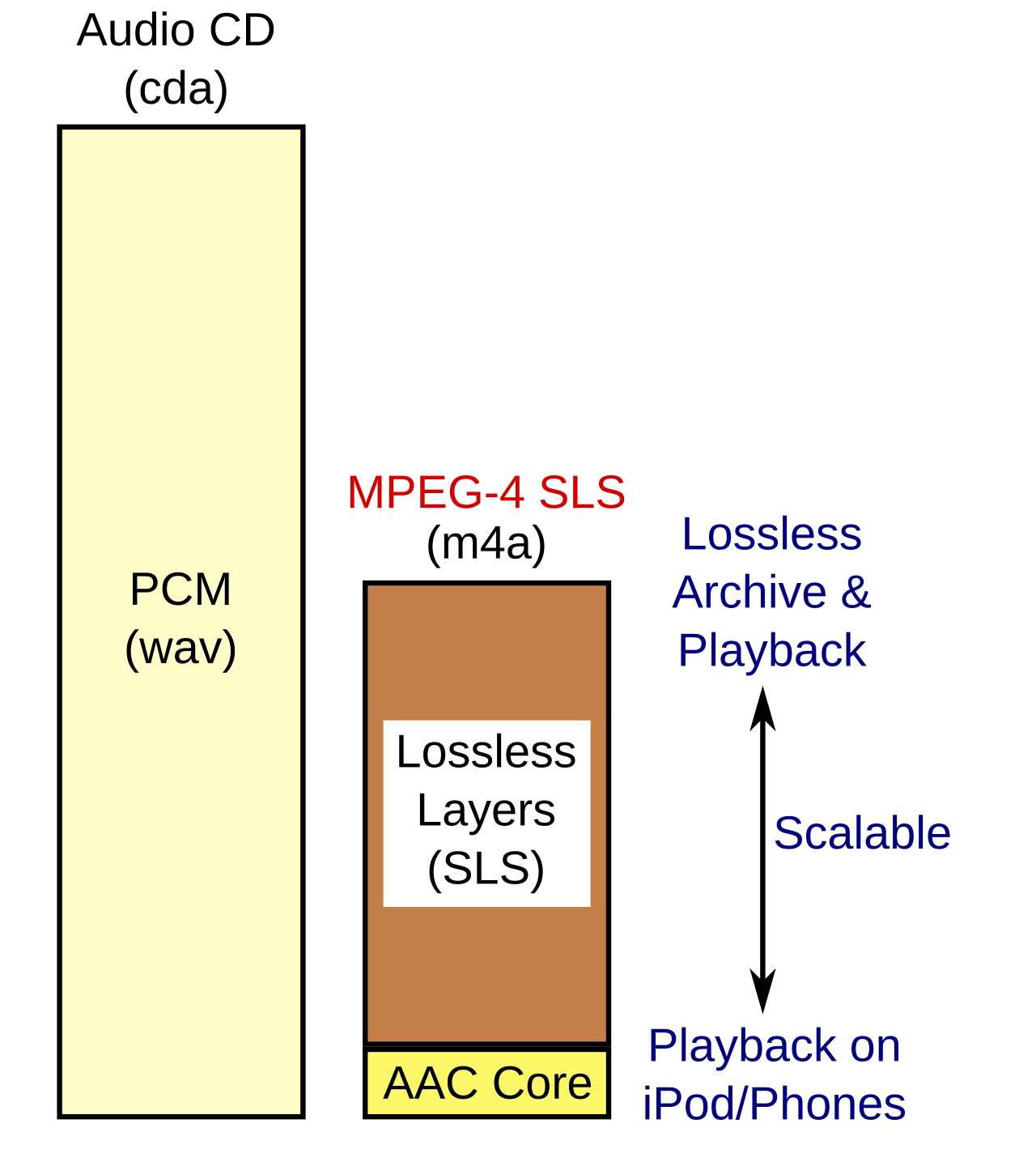

Now, let’s get back to the confusion mentioned earlier. Does AAC necessarily mean lossy? I don’t know. But if you look at Wikipedia’s table comparing different codecs below, it shows that AAC can use MPEG-4 SLS lossless audio compression (something that mp3 doesn’t).
Now what is this MPEG-4 SLS? Probably more technically equipped members can read the following and explain it well, but SLS stands for ‘scalable to lossless’
As the article mentions, it’s an extension that allows having both a lossy layer and lossless correction layer. It can also work without a lossy layer. I quote - “On top of the core AAC codec, a scalable extension layer increases the signal-to-noise ratio, reaching lossless quality at data rates comparable to those of pure lossless audio codecs, that is at average compression ratios of about 58%”.
Now, I cannot be sure, but probably this means that even AAC could potentially SQ approaching pure lossless. Definitely better than 320 kbps mp3. Question is, whether the AAC transferred by AirPlay uses both the lossy and lossless layer? If it does, probably CXN (and other receivers) take the lossless layer?
