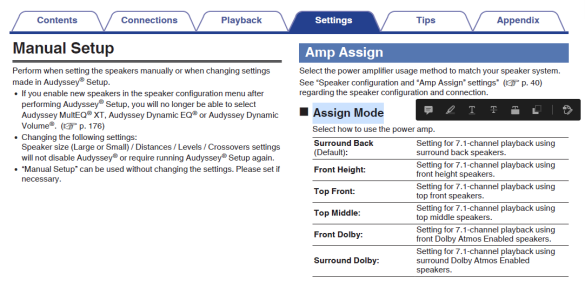

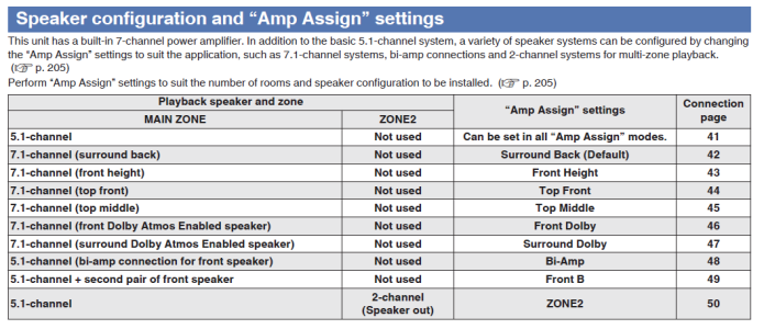

Hello, i hope someone can give info about my following question:
i have a Denon AVR-X1700H DAB receiver and 2 Teufel Ultima 40 speakers
i am so confused about what the default assign mode is for the receiver and which i should best use...
now my amp assign setting is zone2 but i don't have a seperate zone...
Hi Michel,
As long as it is displaying "Main Zone" on your amplifier , its fine.
When you run Audyssey XT32 , it will ask you the number of speakers or if you have a subwoofer.
You may need to choose your option accordingly.
I may be wrong but minimum configuration via Audyssey XT 32 may be 5.1 but you can use the avr in stereo mode after calibrating.
You use surround back speakers only if you have them else pls don't choose that option if you can do so.
