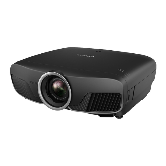

Hi all . what may be the reason for projector getting aoto switched off after every 12-15 mins of playing .there is no overheating indicator on
I have grounding issues (almost absolutely non-existent grounding) of electricity which will be sorted out in a day .
Even with my power amplifier was going in for auto protection mode after playing for se period of time.with changing the plug point it was sorted out
All these started since a day .
Any suggestions are welcome.
Will need to test it again after the grounding issues sorted out.

Hi i couldn't wait so i removed the filter and cleaned it as suggested .i also did all configuration reset on the projector.
I could play it for 25 mins without hiccups still doing good
It crossed critical time of 15-18 mins.
So be ware such a thing can happen and a simple remedy will solve the issue.

It's easy just remove the filter cover on front to left of lens
Pul the cartridge filter out
Gently tap it and use vaccum suction and reintroduce.
It's like removing battery cover
Hi the problem reappered. I did factory reset again it was getting auto swithoff intermittently not all the time.
So as suggested i raised complaint on customer care today morning at 9 and gave them details of serial number.
At 11 i got call and service engineer visited at 4 pm
The usual problems are
1.lamp issues needed to be removed and reinstalled .he did that
2. The lamp requires 440 v it seems so inside the projector they will have voltage blast , sometimes that will be at fault .that needs to be replaced.
He didn't even ask for invoice.thry have it all online.it was 1.2 yrs old . warranty is for 2 yrs for projector and 1 yr for lamp.
He has reinstalled lamp and suggested me to run it for 2 days if it persists then the blast unit needs to be replaced ofcourse free of cost .
Complaint will be closed once i give them clearence.
Epson customer care was really helpful and i didn't feel any stress .
Price for new lamp for 9400 is 7.5 k
In my case the same lamp was reinstalled
