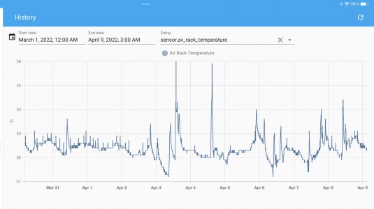

I have a slightly unusual setup in that my AVR, streamer, Int Amp etc are all housed in a hidden closet under the stairs (in addition to a server that also generates fair amount of heat).
What this means for me is that I use a laptop cooler very similar to @amrutmhatre90 on top of the AVR and 3 X80mm fans (2 push, 1 pull) on the closet (Pull fan at bottom)
Taken together, they seem to do the job quite well.
Here are the readings over the last few weeks from the fan controller sensor - which is mounted right next to the exhaust from the cooler on top of the AVR. The peaks (which also indicate remain well below 40C.
Considering this is almost peak summer in Pune, I’d say that using a laptop cooler for a open space AVR (or laptop cooler + closet exhausts for a closed cabinet setup) should be adequate and more
