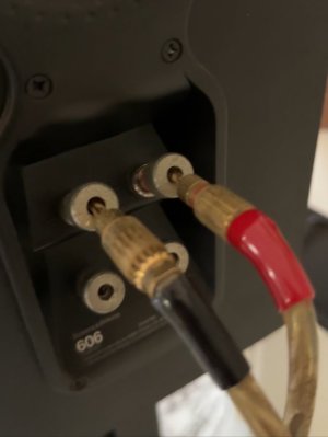

Hello all
I have problem with my speaker B&W 606 tweeter sound is very low hardly auible. But it is working. I connected another speaker to same connection i mean biwiring tweeter decent volume.
Kindly help

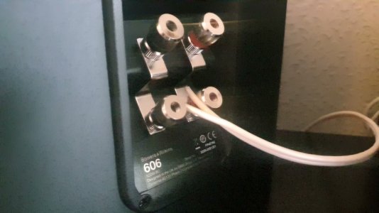

Hello all
I have problem with my speaker B&W 606 tweeter sound is very low hardly auible.But it is working. I connected another speaker to same connection i mean biwiring tweeter decent volume.
Kindly help

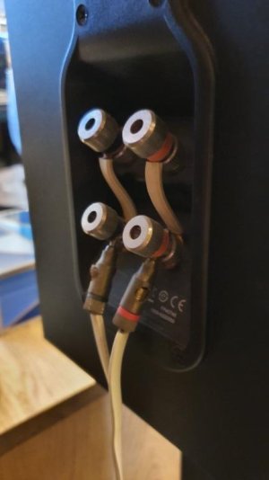

Hi rajesh :)
The links connecting the lower binding post to the upper binding post are missing. You need to have the lower and upper binding posts connected, with usually a small wire or rod connector that B&W should have supplied.

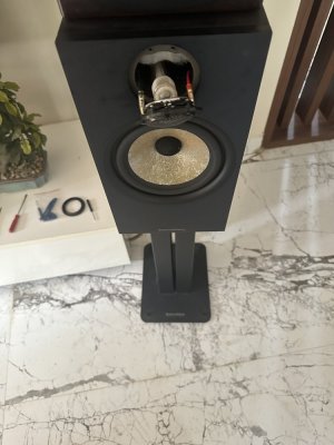

did you take the tweeter apart ? It looks like tbe diaphragm is still attached to the tube like part and the terminals are still on the front plate. If not, if the tweeters are burnt, the replacement for this is easily available at bowers and Wilkins as the model is still not outdated.
If the other speaker(from the pair) works as expected, probably one tweeter is partly blown. Did you try swapping the tweeters across the speakers? I mean exchange left speakers tweeter with right or vice versa?
Swaped the twitters faulty one has very low volume i think this one needs repair😭
