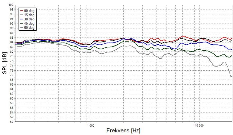

Toe-in can affect the smoothness of frequency response IF your speakers have poor off-axis response. This is because you never hear a speaker alone, you always hear a speaker and its reflections. So even when the speaker has flat on-axis response and is pointed towards you, the side of the speaker is pointed towards the side walls. Reflections coming off the sides will sound very different from the direct sound from the speaker. When they combine, it will result in very uneven response.
Below is an example of a speaker with poor off-axis response. Notice that as you move off-axis, the high frequencies don't just roll off, they really change in character.
By comparison, speakers from Kef or anything from one of the Harman lines (Infinity, JBL, Revel) will have very consistent off-axis response. Side wall reflections from these speakers will sound very similar to the direct sound from the speaker. When they combine, the sound of the speaker won't change.
Below is an example of a speaker with decent off-axis response. Naturally, the higher frequencies are going to roll off, but it looks fairly similar to the on-axis response.
Toe-in will affect the frequency response smoothness of the top speaker, but not have much effect on the frequency response smoothness of the bottom speaker.
