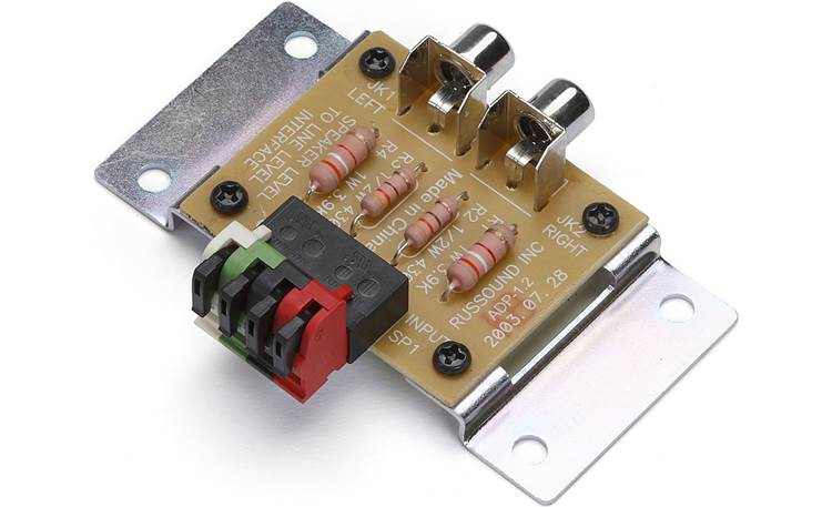

Rythmik tech team recommended a SPEAKER LEVEL to LINE LEVEL ADAPTER/CONVERTER like below;
Thanks, this seems like a simple resistor in the path. Can be done as diy.
