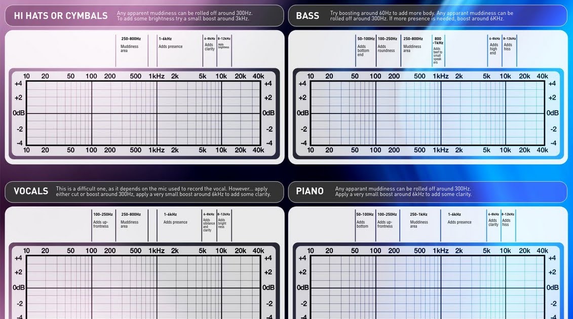

Check out the frequency charts of various instruments and see if you really need a sub for music :).

Subwoofer add weight to the music... The graphs won't let you experience that.
