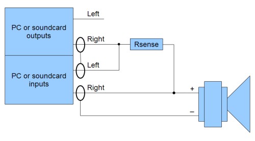

You don't need professional equipment to measure T/S parameters.
Impedance Measurement

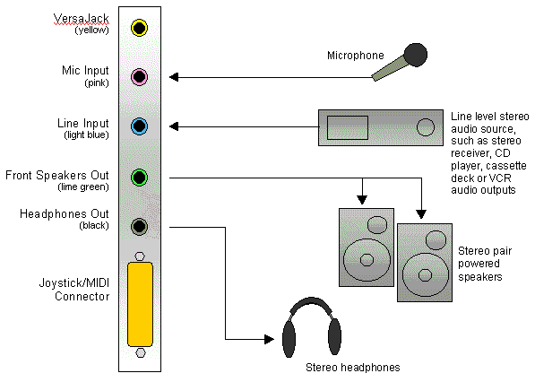

In the following Image what does it mean by sound card inputs? :confused:
Is this means the Line Input Port? :confused: (the blue one?)
Sorry for noob Question :p
Also I do not know the concept of Sense Resistors. What are they and How to use them?

Soundcard inputs = Line in
Rsense = a resistor of known and measured value. 100 Ohm 1W will do. It's mentioned in the article.
