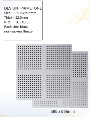

This area has been quite confusing for me actually and it’s great that you highlighted it. So my walls are made of Aercon Panels. And just as you said, the installer is planning 1 layer of 1000gsm 50mm polyfiber wool and then perforated acoustic gypsum board fixed to the frame finally covered with acoustic fabric. For ensuring reflection he said he would add whole gypsum boards instead of perforated gypsum board in around 1/3rds of the area. Additionally he said he would add 4 bass traps. Is this a good solution? Diffusion panels are very expensive, though he said that could also be added according to budget.
Could you please elaborate ?
Ask him what will come behind the fabric and the perforated gypsum board?
What type of perforated gypsum board ?
There are many ways to design and implement low cost diffusers.. have been reading in depth and research this stuff since 5 years..
But yes .Ready made diffusers are super expensive..
Use absorption to bring the RT60 to desired level and use diffusion to treat first reflection...
Note- enough distance is needed between listener and diffuser to work properly.
50mm thick layer of 1000GSM Polywool comes behind the fabric and the Gypsum Boards.
He said its the Generic acoustic type gypsum Board. So his Design is to add 2/3rds of Perforated Gypsum Board(for absorption) and Balance 1/3rds Full Gypsum Boards(for reflection).
So to summarise his plan: A 50mm layer of 1000 GSM polywool is placed behind the acoustic fabric and the gypsum boards. The gypsum boards is a mix of around 70% perforated gypsum boards (for sound absorption) and around 30% regular gypsum boards (for sound reflection)
You didn't get my point..
Layer 1- fabric
Layer 2 - gypsum
Layer 3 - 50mm polywool
Am I right ?
Is there any 1cm foam between layer 1 fabric and layer 2 gypsum ?
OR is it 50mm polywool behind fabric and also behind gypsum board ?
Yes you are right.
No there is no foam planned in between these 2 layers of Gypsum and Fabric. I could insist on that if required.
No no.. that's what is not to be done...
But what type of gypsum board is being and how much it will absorb it the question..
If there's lot of absorption then the reverberation drops severely making the room sound dead
