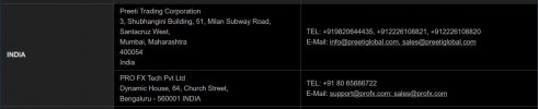

Most welcome Amit. Mr. Placid works for PTC. PTC also deals in Accuphase apart from Denon. The Mumbai Dealer is PTC & Bangalore is Profx as per the link from the Denon site.
Denon Dealer Site
I would suggest to talk to Mr. Placid & find out how reliable the technician is.
Regarding factory resetting the amp, I wouldn't hesitate to try it if it saves the headache of taking it to the technician. Internet connection can always be done again. A friend's Denon would go into protection mode on starting. It was a minor issue & got solved. I'll try to find out from him & let you know by tomorrow.
