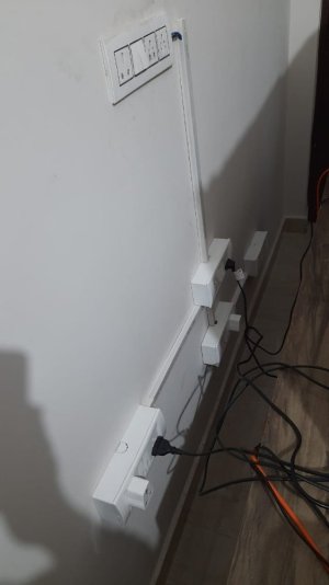

ok so the top modular socket which was installed when my new room was built and underground wiring done has phase on left side and recently i have got these sockets on bottom which are 4 in total are coming out of this top modular socket. Now these recently installed sockets all have phase on right side but on top modular socket it has left side phase. any issues? should i get phase rewired?
Yes. Do get the phase rewired where you have the phase on the left side. meanwhile tell me the phase to earth voltage reading. This wiring must have been a local electrician you hired to get those sockets fitted. Don't ever take any electrical/earthing advice from him.

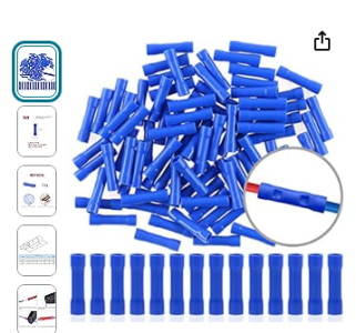

You join wires by using butt joints like these
