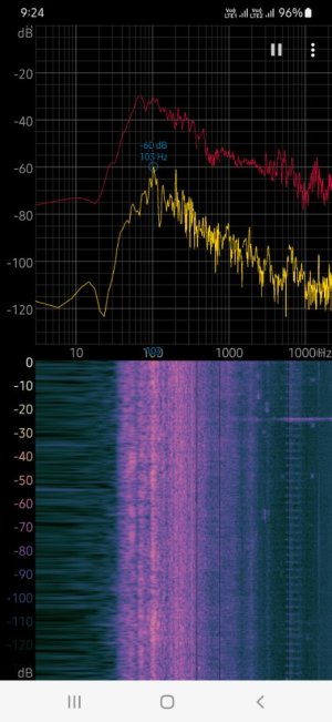

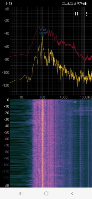

These 2 taken when inside case and outside of case what now

I'm not able to view the numbers clearly but it looks like you have noise, peaking at around 120 Hz being fed or generated in both the channels. The noise may be in your electrical line. Best is to take the avr to some other house and check the same. This is not a pure 50 Hz tone.

If screenshot_20240904-212441_spectroid-jpg.86430 is from "inside" and screenshot_20240904-211854_spectroid-jpg.86431 is from "outside" then I interpret them as below. Hopefully, I've interpreted correctly, else someone who can do better at interpreting these can help.
There appears to be a -60dB peak at 103Hz when the AVR is kept outside the cabinet that intensifies to -44dB at 100Hz (??) when inside the cabinet. Whatever is causing the hum is present regardless of whether the AVR is inside or outside the cabinet. The cabinet just resonates with the sound and makes it more apparent.
As to what is causing the spurious signal, it's difficult to identify when you've got too many variables in play.
As suggested by all the FM's on this thread begin a process of elimination starting with checking the AVR at another persons place "where the electrical wiring is not all messed up".
Next get your wiring checked and fixed by an "actual" electrician.
If after this your AVR still presents the same problem go visit a couple of showrooms/locations and examine the same make and model of AVR to check whether all of them exhibit the same behavior as yours.
If they do, then your problem is not a problem but a feature of the AVR. Your choices will be to mitigate it to the extent possible or sell the AVR and move on. If they don't exhibit the same problem, take your AVR to the dealer/service center, recreate the problem you are experiencing and show proof of AVR behavior that you have noticed at other showrooms/locations vs your AVR.
If unable to do any/all of this in an organized, methodical manner, I guess you'll have to either live with this or yell and scream at Denon/the dealer and hope that they give you a replacement (this is a long shot and appears unlikely to work, given your experience with them so far).

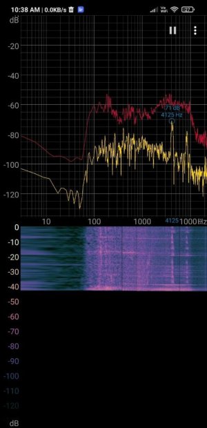

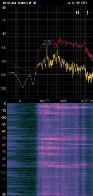

Just for the heck of it I decided to Spectroid my AVR (Marantz) that is kept out in the open. The attached plot baseline.jpg (shows the ambient noise) and the AVR-on.jpg plot shows what Spectroid sees when the AVR is turned on. Ignoring the two HF spikes 4125Hz and 4125+Hz from a nearby squirrel there isn't any peak in the plot and the waveform is generally the same allowing for ambient noise.
To recreate your enclosure issue, what if you place your AVR in a plywood box that has one side open and see if you are able to recreate the issue. If the problem can be recreated with the box, then you have a portable test bed which you can take with the AVR to the dealer showroom/service center.
