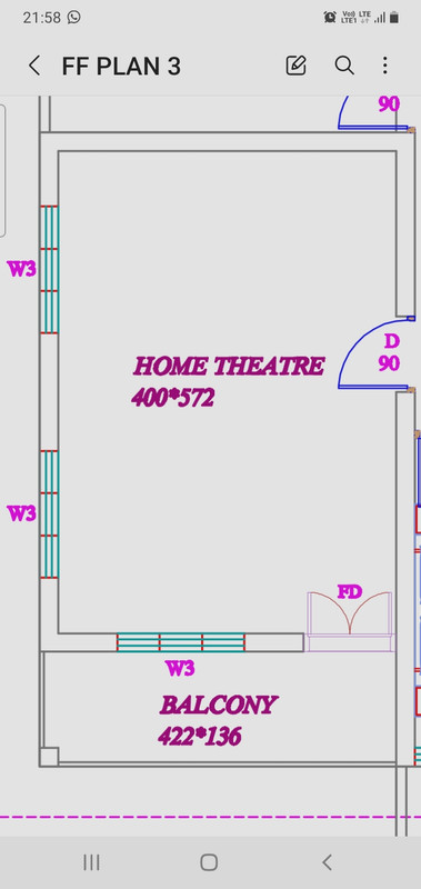

Since I have a lot of space left in the lounge area, so planning to have a HT/TV in there. Below is my initial thought on adding a screen/TV and speakers. I can forsee that most of the time the source would be OTT platforms rather than discs. Current stage of the construction is, the slab of the basement will be casted in 2 weeks time.
My plan is to keep the lounge area totally rustic, no false ceiling,concrete walls etc .
I guess the speaker cables to the rear can run from floor? I don't even mind if they are exposed and run along the walls.
I don't know much about HT rooms, so any inputs that are important at this stage of the construction would be of great help.
Number of channels are not decided yet, markers are just indicative.
Thanks.

First thoughts,
1. Your 3 seater sofa is too far back, so unless your screen is humungous some of the effect will be lost. Plus from an audio perspective will be good to leave space at the back for diffusors.
2. Try and fit a false ceiling with acoustic tiles and run pipes of 2 inches from rack to the back of the room for future proofing connections.
3. Keep power connections on all four corners for ease of subwoofer placements
4. False ceiling will also help for atmos speakers around the seating area (Top front and Top rear)
5. You can keep the study desk behind the sofa ( a bit like naturelover's design) so you can keep that as a separate area

Thanks @sud98 . I see the problem of seating too far away from the screen. Shifting the desk to th| other end is may be a good idea. It gives me more space to place the fronts further apart, which is good I guess.
Thanks for your inputs

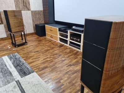

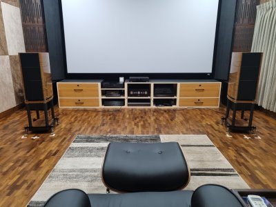

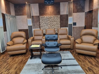

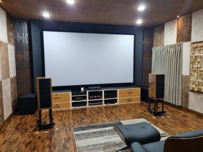

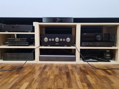

I was able to finish off the work of my dedicated listening room / Home theatre couple of months back. Could not post pics/details since I was busy.
Home theatre
Source - Reavon ubr-x100 / Nvidia ShieldTV Pro
Projector - Sony VPL-VW290ES
AVR - Yamaha AX6A.
Speakers - Monitor Audio W380 IDC for LCR.. Dont remember the model numbers for surround and atmos.
Sub - Dual SVS PB 2000 Pro.
Screen - Acoustic transparent one from Elite. Dont remember the model.
Stereo Setup
Source - CEC TL5 CDT / Auralic Aries Femto
DAC - Denafrips Terminator II along with Denafrips Hermes DDC.
Amp - Sugden Masterclass IA-4
Speakers - Wharfedale Elysian 2.
Power conditioner - Audioquest Niagara 1200.
Whole room is powered by a dedicated 3KVa online UPS and an isolation transformer.
20220820_214143.jpg20220820_214158.jpg20220820_214235.jpg20220820_214356.jpg20220820_214632.jpg
Home theatre
AVR - Yamaha AX6A.
Stereo Setup
View attachment 71326View attachment 71327View attachment 71328View attachment 71329View attachment 71330
Hi @Miany
That a very lovely setup and nice room. Delight to have a look. Your HT speakers are behind the screen? How big is the room (LxWxH). Whats done on the ceiling? Do you really feel a huge improvment after the room treatment?
Is it a DIY or you got it done from some professional? Looks professionally done though. I think its better to combine both Stereo and HT in the same room, it will save me a huge amount of money, lets see.
Hey if you don't mind, how much is the total expense on the treatment?
Enjoy :)
Hi @Miany
Yes. The LCR speakers are behind the screen.
The room is 24 * 17 * 10 feet. Ceiling has been treated with Rockwool.
Absolutely. Its a must if you ask me.
Its done professionally only. Since i wanted both the stereo and theatre in the same room, it was not possible to build it like a normal home theatre. The acoustic treatments were essentially done keeping stereo as priority.
It will save money for sure. Initially, I had some apprehensions about the stereo performance in this room. I was skeptical about the screen coming behind the stereo speakers, inherently limiting the minimum amount of space between speakers. No adjustments are possible which involves bringing in the speakers closer since it will hinder the screen. But luckily for me, i was able to get an optimum position without any issues. Probably will have to do with the Elysians as well. Once properly burned in, these babies are something else.
Enjoy :)
Will PM you.
Will PM you.

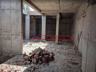

Hi FMs

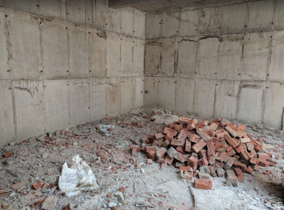

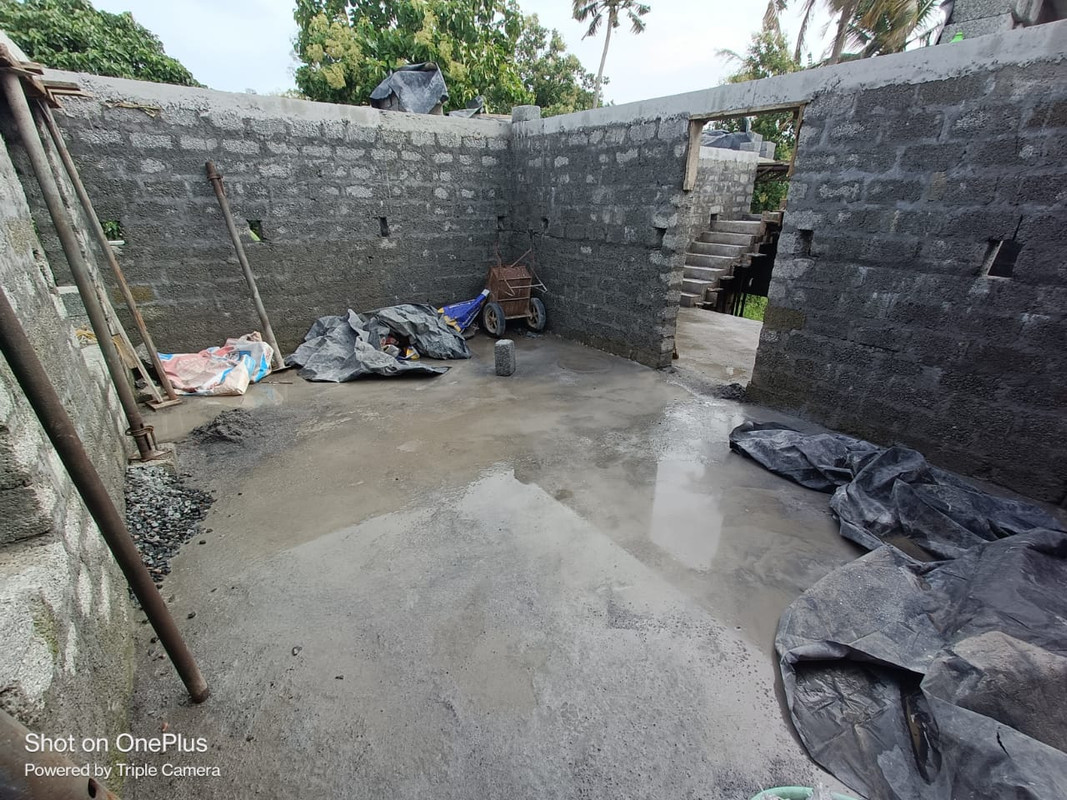

Excited to share that the strucuture of my new house is complete and finsihing work is going on. Need your help on the ceiling for my listening room.
Its a dedicated room of 18x14 feet, no windows, just concrete walls all around with a door (in the middle) ofcourse ;) . Since its in a basement so there is a lot of echo in this room. I hope that will be tamed with some carpet and furniture later on but have plans to do some kind of room treatment but not for now.
My query
I am going to start with false ceiling work in the house. Even though I am not in favour of false ceiling but especially in listening room there are lots of beams etc, so no choice but to do the ceiling. Are there any special materials for listening rooms or it can be done like other rooms? Channel, net and then POP and then paint. I have heard about acoustic tiles etc but no experience with those. Or is there al together different kind of ceiling for listening rooms.
Please advice.
