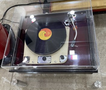

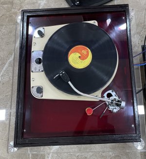

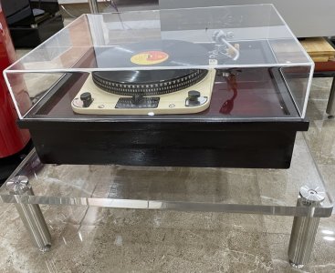

Hi folks,
After a long hunt,finally could get hold of Garrard 301 in Very Good Condition.TT fitted with SME 3009 Tonearm,
SME headshell & Audio Technica AT3600 MM Catridge.
My Preamp has built-in phono section with separate MM & MC inputs. Will be playing 80s & 90s (mostly ILAYARAJA & few bollywood films) LP records.Though the existing entry level AT3600 catridge provides satisfactory resolution/details,would like to upgrade to higher end MM or MC Catridge.
Prefer to go for MC Catridge as the same retrieves better resolution/details than MM Catridge.
Since my usage is for playing old LP Records ( 80 to 90% condition),whether MC catridge would
extract/produce more noise than MM catridge?
Looking forward to FMs valuable feedback.
Kindly suggest various Catridge options (From $200 to 350) suitable to use with SME 3009 Tonearm & headshell.
Thanks.

The SME 3009 Improved tonearm permits a max VTF of 1.5 gm. Not many MC cartridges track in that range. You might be better off with a good MM cartridge like the Ortofon 2M Blue, or the Audio Technica VT95 options...
Btw, the On /Off and Speed Selector buttons have been replaced. A previous owner might have broken the originals by forcing a speed change while the TT was spinning. I guess you are aware about the locking arrangement

View attachment 80312View attachment 80313
Beautiful 😍.
Congratulations.💐💐
Welcome to Garrard owners club.😊

Nice deck. If possible get the non improved sme3009 ii tonearm. It is better than improved being heavier and permitting greater tracking force. The range of MC cartridges you could use will significantly expand.
Most MCs have low compliance. For a good tonearm-cartridge matching low compliance cartridge needs high effective mass of tonearm. You'll probably need a higher mass tonearm if you want to go MC.
the SME 9" work pretty well with Denon from what I have seen. yes it would be even better with 12" but 9" is no slouch
Thanks Reubensm.
Yes, Shure V15 type iii have rave reviews and most satisfying feedback from users across various audio forums.Shall keep this in the short list.
Have come across Classic Hifi shop web and will be replacing the knobs in some time.
I know I am very biased when it comes to carts as I have inherited the love for Shure from my father. Just wanted to suggest that if you ever decide to take a Shure path, make sure you collect a few OEM Shure NoS styli on the way. That will ensure you've stocked up for the rest of your listening-life. Jico makes some great styli but the OEM Shure styli (especially the American made ones) have their own charm.
Dear FMs,
Below Cartridges are shortlisted. Looking forward to know about your listening experience or opinion about these cartridges.
Hope,all these catridges are suitable to use with SME 3009 ii improved tonearm with SME fixed headshell.
Moving Coil with recommended tracking force of 1.5g
  • Ortofon MC -30 (VTF Range : 1.3 to1.7 g)
  • Ortofon MC10 (VTF Range : 1.3 to 1.8g)
  • Denon DL-301 II (recommended tracking force : 1.4g)
MM with recommended tracking force of 1.5g
  • Ortofon 2M Bronze (VTF Range 1.4 to1.7 g)
  • Ortofon 2M Black (VTF Range 1.4 to1.7 g)
  • Nagaoka MP300 (VTF Range : 1.3 to 1.8g)
  • Shure V-15 Type iii (VTF Range : 0.75 to 1.25g)
