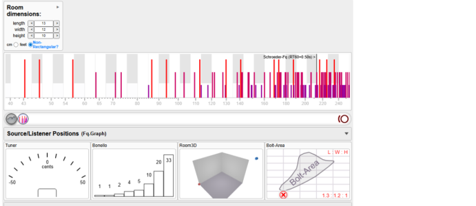

I'm currently operating a 2.0 speaker setup that consists of a QA3050i speaker(-6dB @ 44Hz pretty decent by slightly muddy) driven by a Marantz NR1200 stereo receiver in Pure Direct Mode, with a Wiim Pro streamer handling streaming and parametric EQ duties. My living/listening room is an untreated 13x12 feet.
I'm looking to add a sealed subwoofer with tight bass to the system, and have updated my options and narrowed them down to (SVSsb1000pro @70K, Rhythmic L12@85K , REL HT/1003 @72K) after thorough research. I skipped REL T/5X as I want a bit of thump, and bass extension alone may not be sufficient for my tastes; on the other hand, a rumble is something I want to avoid. Given that my listening preferences are primarily acoustic music and vocals, classic rock, and sometimes POP/EDM, I'm uncertain which subwoofer would be the better match for my setup. I am unable to demo any of them, so I am looking for recommendations. I plan to use REW to program the PEQ in WIIM for a better integration, if that is even possible.
I would appreciate any guidance on this decision. Room sim done from
