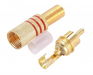

Hello,
I am experimenting with RCA interconnect cable (like everyone here).

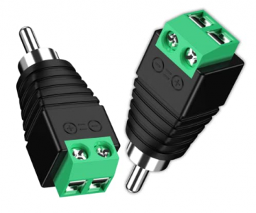

So far I have tried Screw Terminal Connector like below with CAT5 cables and it works well.
I wanted to try Generic RCA Plug Gold Plated from amazon with shielded cables/CAT 5 cables
Are these any good?
If any specific one good, Can some one link that?
I don't want to spend a bomb on the connector/cables.
Thanks.

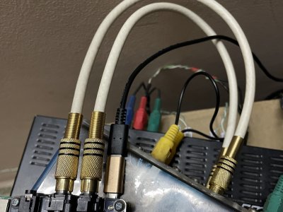

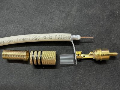

Got the connectors today, they seems to be of good quality.
Going to try with Belden RG6 with copper core and silver shield and foil.

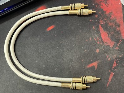

Tried the cable. It worked without issues.
Is there a big difference? Not to my ears :-)
But looks much cleaner and solid than CAT5 cable.
