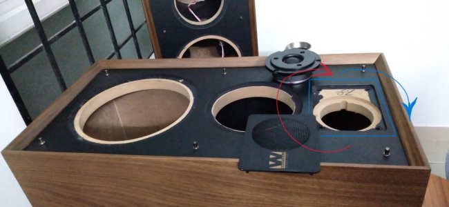

Small question, please: I have two left speakers, do you think it's possible to roll-over the tweeter for one of them, please?
From my understanding, removing the face plate of the tweeter is rather easy, but I don't know if it's possible to change the tweeter's enclosure position, is it a one piece with all the other inclosures?

Hello Bala, wonderful job, well done!

Hi Viktor,
Lintons tweeter are off centred. To convert one of your left speakers to right speaker, woodwork is needed. Even after that the Linton logo on tweeter face plate will be upside down, still the grills will cover that.
Hi Viktor,
Thank you, I was affraid it will need woodwork, they complicated this part a bit. But I don't hear anything distorted or not right, it's just from an aesthetic point of view. I will leave them like that, thanks again for your time. Regards
