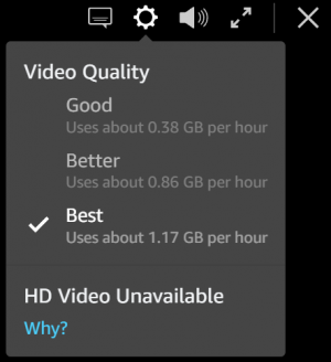

I've been using couple of these for 4 to 5 years now. Its 30-40% of the time a big miss.
earlier( when using pc->TV) - prime video use to scale down to SD version , or loss in video quality
Edit - It still happens right now ( using extender ).
