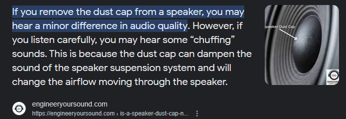

This also helps in keeping the Speaker Enclosure from any leakage , depending on the volume / ported/sealed ( including raw driver design ) i.e the pressure exerted by the diaphragm will change .
looking at the TS parameters from the original - there is a possibility of changing the frequency response a bit.
Vas(Air volume ) can change.
Moving mass can change.
of course - my opinion.
like the above article I already posted. may be there's a difference while a very keen listening, as of now I think to use these as they are. I will check for a 1.7" dust cap in the local market :)

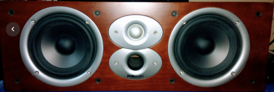

i discovered my polks' suffering from the dust cap cracks some 3 months ago...side fronts RTi A5s and centre A6. i simply removed them carefully and have continued using them. frankly i cant hear any difference so i will continue to use them till i am able to buy new dust caps and stick them on. it is a simple job and the glue and new caps should cost may be 500/- or so. any small city will have many electronic spare parts shops selling all these items. but i wouldn't even think of spending that kind of money....

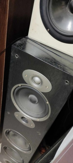

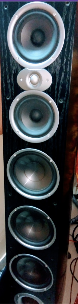

I'm surprised. Maybe the quality has deterioted. These are my RTiA9 towers and CSiA6 centre speakers. I have the FXiA4 surrounds too and all of them are from 2012. Absolutely no sign of any deterioration. I thing I always do is to put on the dust covers when I'm not listening.

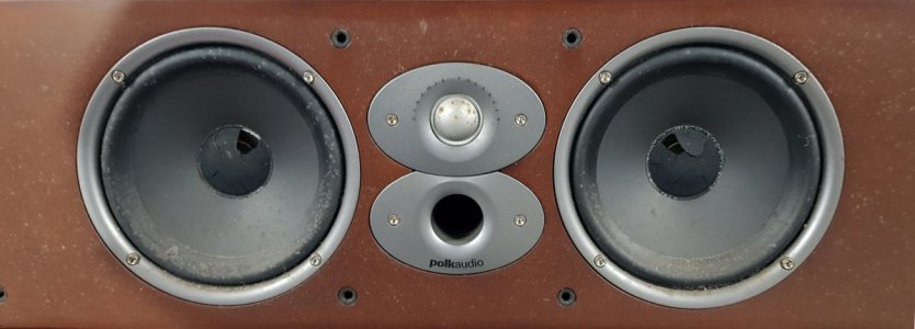

Is this in a dark room? It looks like fungal growth. Just few minutes of sunlight (especially during the monsoon) will avoid fungal growth.
still good - since April/May 2009.
Just the usual dust. Also the duct caps seems cloth like - not hard when pushed. So , not sure these have changed over the years.

Just got the same issue with my CSi A6, one side was torn, not sure how and when. Will find a replacement cap when I can, easily available in US.
@dinesh1201 were you able to find a dust cap, I will get otherwise get it from US later.
Adding few drops of acetone on the rim of the dustcap carefully and waiting for 2 minutes for it to soak. After that you can pull the dustcap from it's place easily. You can put a replacement cap by gluing it with a rubber or resin based glue. Hope that helps.
