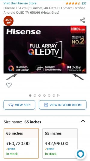

Hisense is launching U6G in India with Big Billion days (55", 700-nits, FALD at ₹60k)

Grabbed Hisense u6g 65 Inch for just 40k from my Friend who was moving to the US for good. It was just 3 months used. Already had an ageing 54 inch TCL which was ose to 4 years old. Couldn't resist the deal. I already recommended this to couple of my friends and I felt there's no TV in it's price range which can compete with it particularly the 65 Inch.
