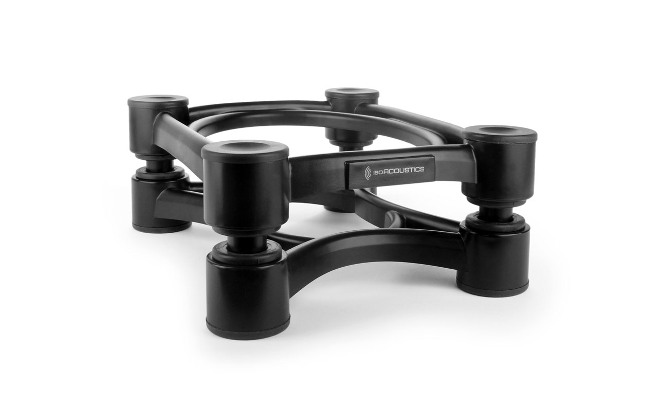

Vibration is not a very big issue for me but I want to know if this iso200 stand can make significant improvement in sound. can dear FMs adviseIf your budget permits, vibration from sub can be isolated using isoacoustic stands for sub. This’ll improve your low end punch at the same time won’t rattle the room. If you’re playing at around 75-80dB average volume at listening position, it should be ok and won’t make the neighbors call the cops
ISO-200SUB | IsoAcoustics
The IsoAcoustics ISO-200SUB Acoustic Isolation Stands are available for front and side firing subwoofers used in professional studios, project studios, HiFiwww.isoacoustics.com
