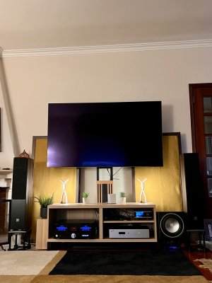

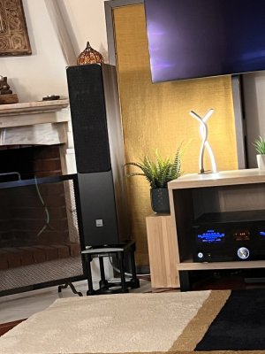

Use isoacoutics stands, I have the Oberons 5 and Im amazed with the results, their now at ear hight, isolated from the floor. The improvment in stereo image and clarity was jaw dropping 👌
It’s interesting to see tower speakers placed on these types of stands. Are these stands stable? And by the way, which model is this? ISO 200?
I also have the DALI Oberon 5 speakers and am looking for a solution to elevate them to ear level.
The stands can support way more weight than the Oberons, its solid and do the job of decoupling perfectly. Its
Isoacoustics Iso 155, the sub has the 200 series. For the price they cost it was the most impactful tweek to the system. The result is an enourmous stereo field, clearer imaging and the total disapearing of the speaker (mind you that I have a treated room, raising the speaker made the panels more efficient in absorbing thecreflections)
