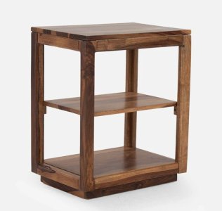

The best way out in the given situation is to mount the TV on the wall, get rid of the tv unit in its place put something far less space consuming(pic attached below) to place the amplifier and later a centre speaker and place SEALED bookshelf speakers on stands about 6-8inch from the rear wall. Front ported speaker might also help with placement close to the wall.

as i cant wall mount thats why i boguht this new tv unit. So i guess i will put bookshelf on stand then
