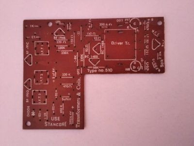

I have assembled both the pocket radio standard PCB and the 2-band L-board PCB during my school days. You are right about the aerial and oscillator coils not mounted on the board. I had these wired directly to the band switch outside the board. This added an element of flexibility as one could change the band switch and aerial/oscillator coil kit and upgrade to a 3-band radio.
Image source: https://www.prohithar.com/l-board-pcb-am-radio.html (use the translate option for the english version)
Thank you for sharing. I am also uploading a picture of the top side of my L-board showing the component layout. This particular board is designed to run off 4.5V DC. My board is an older version as it was designed with lockfit transistors in mind e.g. BF194B instead of its successor, the BF494B. Also the diode type is not specified on my board, but I got it to work with an OA79 germanium diode. Other similar germanium diodes should also work.

quick question, the OP transistors on the PCB are marked as 187 and 188, I recollect using 2 x 128 for my build and later on 2 x 188 on another board which I assembled.
Hi. At the time I constructed the L-board radio circuit, I used two Hitachi 2SB77 transistors and an Indian 'Beco' split phase transformer. I recall purchasing plastic- cased AC187 and 188 but have not tried them so far. I suspect these might be silicon transistors that have been repackaged to substitute the original metal-cased ones. I think two AC128s were used in the Jetking Guru kit.
If I can find any metal 187s or 188s in my parts box, I might attempt to use them and see if the circuit works, of course bearing in mind that this is an NPN/PNP transistor combination.

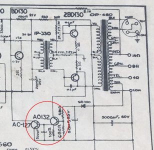

I had a few plastic case BEL 187s and BEL 188s and used them in bias stages as replacements for AC127 and AC132 transistors, in old Ahuja solid state amplifiers. They worked very well in these installations.
