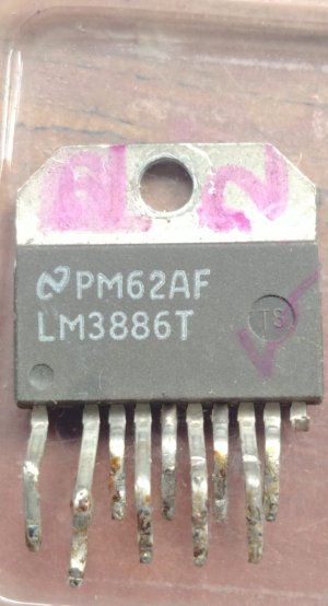

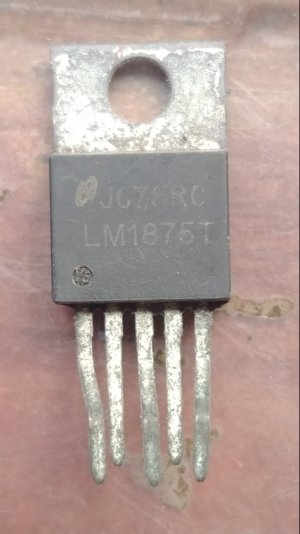

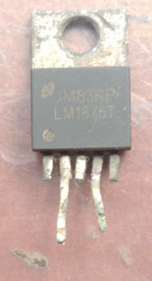

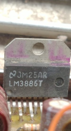

Can You please post pictures of your LM1875T ICs
Fake LM1875 (Img-1)caused oscillations at high freq. Broken pins (Image 2)due to heavy heatsink. Fake LM3886 (iMG-4 ) was DOA

Please post photos for comparison purpose. I got them from Lamington rd - RK electronics. Genuine sample was graciously offered by Kuldeep Singh , diyaudio. All are from 2012

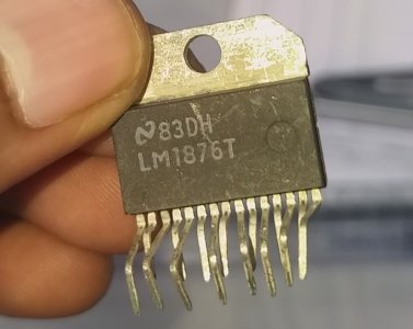

Here is the LM1876T ,which is available in stocks, seller asked for 350 rupees each, I have some doubts about originality
What are your thoughts about this View attachment 72440
The logo looks good to me, compared to my fake LM1875, it appears a bit compressed. If you have multiple samples, Short circuit survival at full signal and distortion / clipping pattern at full power on an oscilloscope are some of the test. Fake ICs burn out in these test conditions
I knew that much, any physically indication of Original ICs
