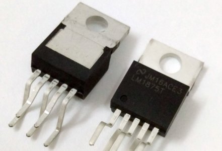

The only genuine one's you will be sure of is to buy from Mouser or digikey and they will cost a lot with shipping. Genuine one's will be available at Lamington Road but moq is 100. :p
Try rs components too. They stock a lot of stuff in india.
I'm planning to make my own LM1875 PCB. bought ICs from lamington in 2014, at various rates Rs 50-60-75/- each from multiple shops, Probably all were fakes . One IC (Rs50 from RK) had HF oscillations, Tweeter used to make distorted clipping sound. replaced it with Ic brought from another shop, it worked well. I had used veroboard. Sound was very good (for supposedly fakes) at +/-12V @6W P. Ch. 4Ohm speaker when compared to Norge TDA2030(Genuine) based amplifier . Tested up to +/-20V on a dual SMPS . DM me , I have some good layouts.

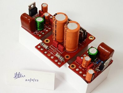

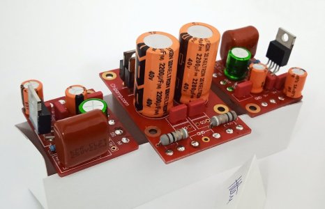

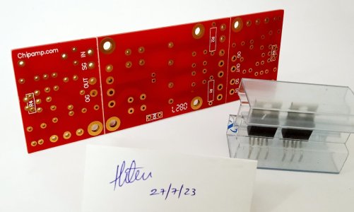

My build with genuine high quality (Keltron, Wima, Nichicon) parts.
(1)
(2)
(3)
(4)

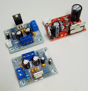

If anyone is interested I have two Chinese lm1875 boards, A TDA7379 Stereo Board. 12-0-12 transformers, and miscellaneous items. Also have some Salvaged Speaker Drivers, transformers, Potentiometers, Tone control board, a small cabinet. switches.... Basically approximately 80 % material to make a diy amplifier. Going very very cheap. Please PM me.
