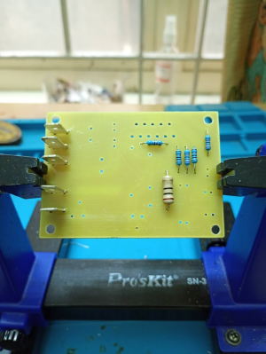

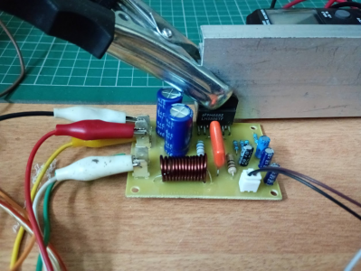

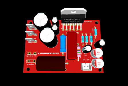

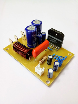

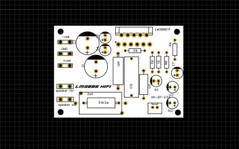

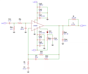

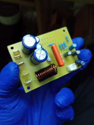

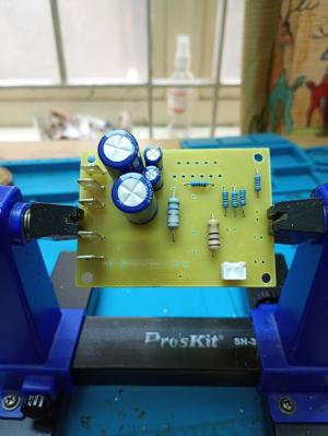

I bought a pair of LM3886 kits about fifteen years ago but never got around to building them, as I ended up using eight audio assembled boards instead. While cleaning recently, I came across the ICs again, but the PCBs and other components were missing. So, I thought of designing a new board for them. I referred to the official reference design, Tom Christiansen’s work at Neurochrome, Scott Campbell’s article on Circuit Basics, and Rod Elliott’s detailed write-up on the LM3886. All of them shared a wealth of information on LM3886-based amps. I designed the board keeping their suggestions in mind, using my favourite layout program, EasyEDA. I left the project aside for a few months, but recently got the test PCB made again. Today it was raining heavily from morning so I thought it was the perfect time to finally finish it.
Upper later pcb u can coat with two paints white and black.
( before u fit the parts)
Use a laser from nearby engraver.. U can burn blacks to make white parts marking.. Giving it a pro look

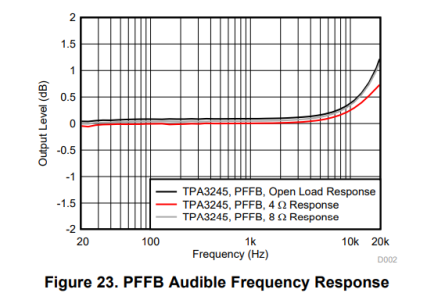

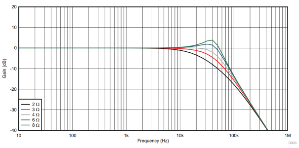

I was also under the same impression, but any chipamp's damping factor and ruler flat FR over varying load impedance is way better than any 3116/8 or 3255 Class D based amps.
Agreed, the frequency response of class-d is irregular at the extreme highs1749800628806.png
Question is when we cant listen past 15Khz does it matter?? I mean that's hardly a peak or dip even at 20Khz.
And damping factor of amplifier is related to Qe of the loudspeaker when connected. Nobody complains that there is 4 ohm or 8 ohm in the coil. It is in series with the amplifier. What happens to damping between the two? Does anybody care? If an amplifier has 1 ohm resistance (just exaggerating) just add to the 4 ohm or 8 ohm and remeasure Qe and its time to move on. Also, damping factor just changes bass just a little bit. It is overrated like most things in audio. Its all about making the right compromises in the end and class-d chip amps from good companies like TI has done that very well.
ClassA/B chips have become vintage if we notice their prices, they will continue to sell at higher and higher prices without any sonic perceivable difference with Class-D. I said perceivable, not measurable, pls note.
And isn't it true that if we increase bandwidth of the amplifier to lets say 100Khz, it has a higher chance of oscillating? Isn't the bandwidth limited by design to a lower value in class AB for safety?
Uneven FR is a bit step backward when compared to Class AB. But in furure , Im sure this tiny FR gap will become unmeasurable . As for me, I can't hear past 16K Hz and can barely notice any difference below 0.5dB. Textbook 20-20KHz human ear response is slightly exaggerated , considering how uneven human ear's FR is
