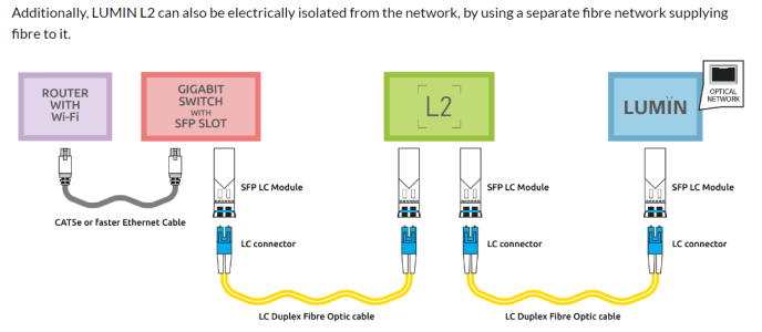

Above is the best connection configuration for Lumin L2 as recommended by Lumin on their website.
And below is their networking guide with a few links to SFP switches and fiber cable to choose from.

The SFP LC module referred to in the diagram - is it built into the L2 or to be purchased separately in addition to the LC-LC cable? Can't we get LC-LC cables with SFP modules? I mean, can't I get a single cable to go from L2 and U2 without writing about issues like 1 GBase vs 10 Gbase, SFP vs SFP+, single mode vs multi mode, etc.? :)
No sir, both the Lumin L2 & U2 only have built in SFP cages of size LC ( SC is twice the size of LC ). So we still need SFP adapter of LC size + fiber cable. This SFP adapter is called as a SFP transceiver.
1) Single mode fiber is always yellow is color.
2). Multimode fiber comes in different colors.
3) Any single mode SFP LC adapter will work with any single mode fiber with a LC connector. So there is no chance of any incompatibility issues here.
4) The incompatibility only arises between the SFP cage built into the Lumin, and SFP adapter used at the end of the fiber.
5) So one can blindly buy any single mode fiber of the required length, as long as its yellow in color, and has a LC connection at both ends.
6) Then buy separately SFP ( Single mode with LC ) cages from Trendnet or Finnisar from Amazon india and see. If we can find the same model mentioned in the Lumin page, then we are in luck.
So to summarise :
1) Single mode fiber with LC connectors at both ends.
2) Single mode SFP transceiver with LC connector at both ends.
So to summarise :

Of the two LC-LC cables needed, the one from the switch to L2 needs to be long and the other short?
Will this work as a single cable solution? i.e., SFP modules + LC cable?
The first fiber run from router / switch to L2 can be as long as is required, without any sharp bends or deformation of the cable. And from the L2 to the U2, it can be short and it can be fiber too. However, best to experiment here, as some folks have preferred going copper here.
