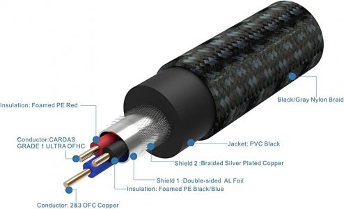

The above picture shows one such 'simple' cable construction.
The Cable above takes it a step further and has identical conductors for the signal and Ground cables.
Note that the external shielding (Tape + Braid) are not essential in establishing the electrical circuit.

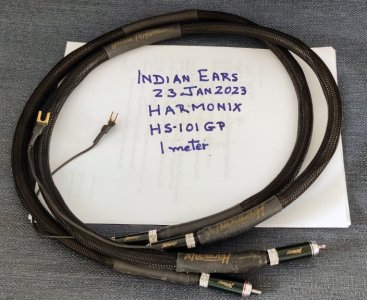

Some manufacturers (Like the Harmonix Cable I sold recently) offer the shield as an optional external Spade Lug termination, to be used at the sending / source side, to provide RF Shielding.
