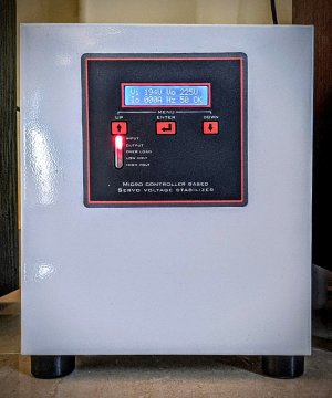

There is a display in my Servo stabiliser indicating these parameters:
Vi - Voltage Input
Vo - Voltage Output
Io - Load (i guess!)
Hz - Hertz

Io is Current out, ampere reading. Yours is a classic example of low voltage boost. The thing is there is a reference range to this voltage stabiliser. You should find out if the voltage drops to 150 or less. If then it has to be calibrated to stabilise very low voltages too.
