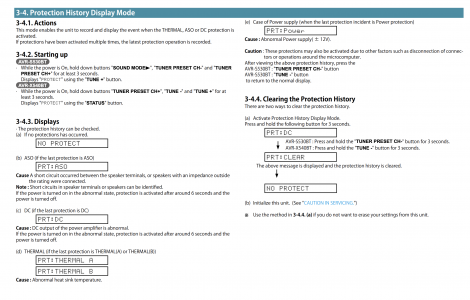

See if you can get the service manual for X250BT. Usually all AVRs have a diagnostic mode which tell if there is any issue after the avr swiches off.

This is an example of service manual. I got service manual for Denon AVR S530BT. On page 71, it tells how to do diagnostic for power problem
So if you can somehow get the service manual, pressing few buttions, the avr will tell you why it switched off
