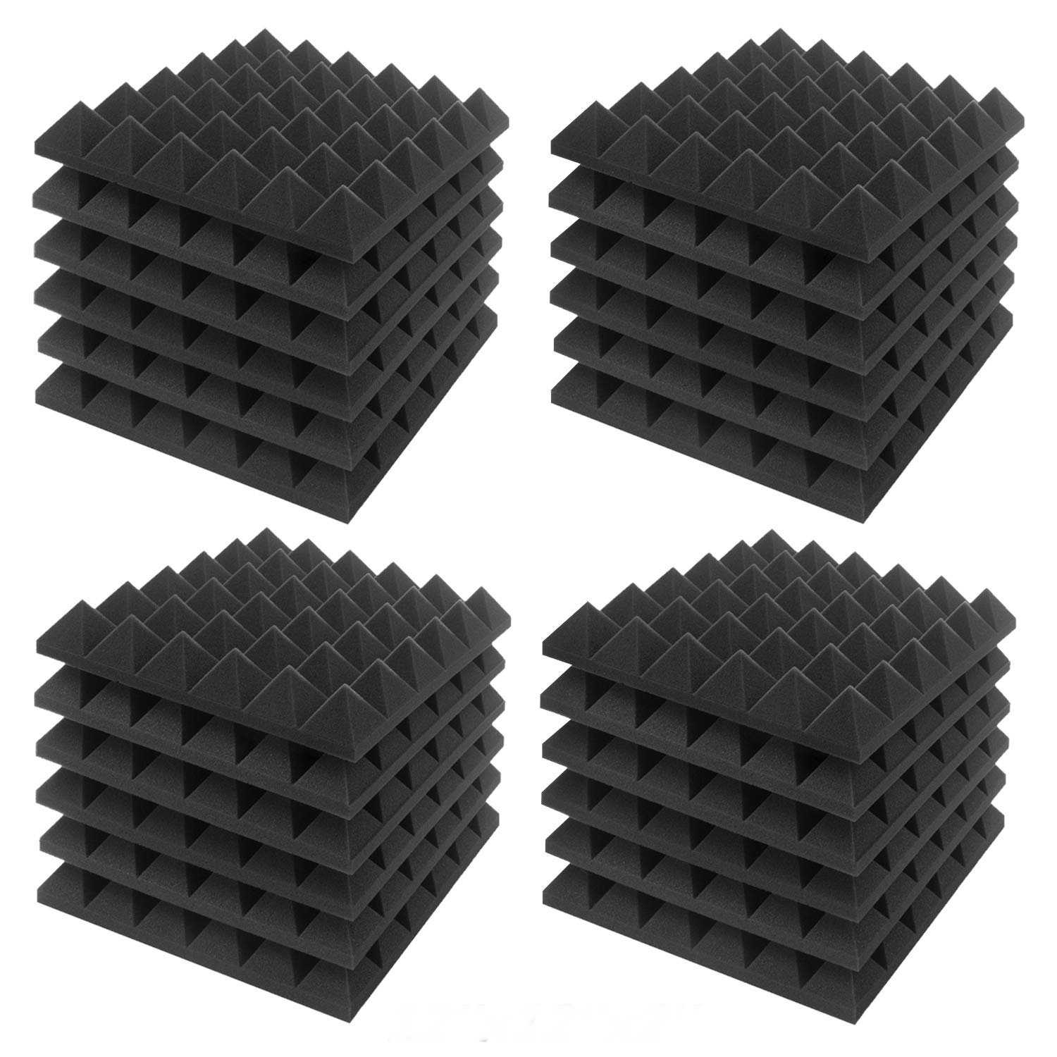

Hi friends got 6 acoustic panels today 1ft x 1ft, i have already installed 4 of them and can already feel big difference. Now i am left with 2 more where should i place them please suggest. Wanted to place them in middle but my wife don't allow to throw out the TV .

If really get big difference then u need more panels. Currently u can place underneath each of the installed pannel.

Yes absolutely.. Thikness should be 2 to 4 inch minimum. More thikness more u get better absorption. And lastly need some diffusers in ur room..

While I am happy for you. I think you will benefit a lot by pulling the speakers further from the from wall and toeing them inwards.
Since 1 ft by 1 ft is a small area if possible make it 2 ft by 1 ft and keep the other panels next to it.

Pulling out further is not possible, i got 2×2 absorber and dont know if i am over imaging but bass have become tighter after adding 2×2 panels

On the side walls, equidistant from the speakers and your listening position, basically the first reflection points.

How did you stick it to the wall, 3M adhesive strips or something else.
I tried using regular back to back tape to avoid any damage to the wall.
However the foam fell down within 12 hours.
So i am now planning to use the 3M tape as seen below

Nope even 3m wont work on it , if you do not want to leave any marks on wall after removal best way i found out is, take any corrugated box cut it in small pieces stick them to foam with fevicol heatx and then stick paper to wall with paper tape. This method worked best for me and cheapest.
