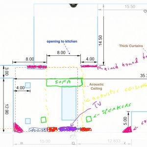

Here is my room layout..
- small squares are speakers
- rectangle in center is the sofa
- dotted rectangle will be the acoustic ceiling
- bass trap in one corner (other corner is really an opening into a passage)

Iam just posting my idea of setting up in that space. Of course all depends on the bosses permission :D
Now let me explain the advantages :
1. You can have wide and deep bass traps in the corner. More importantly you will have symmetric bass traps on both sides.
2. The back is opening into the wide open kitchen. A lot of dedicated rooms are designed like this from the ground up. As the back room ( kitchen in your case ), acts as low pressure vent for the room, and is used for storing kit like vinyl etc. This back opening helps a lot with evening out bass build ups.
3. The two broad band absorbers on the kitchen entrance sides will help in eliminating flutter echoes.
4. If you sit in the sofa at center, with the speakers 4 ft from TV wall, and 8 ft from each other, then you will most likely end up in a near field equilateral triangle. This will give the benefit of not having to treat the side walls, and will counter the negative effects of asymmetrical walls on the sides.
5. With a big flat screen TV mounted on the wider wall. You have enough room on the sides of the TV, to stack panels flanking the TV. And you can play with fine tuning the speaker and panel position, so that first reflections from speakers land exactly on the panels. This will give you good perception of depth in the sound stage. Even though you have a TV in the center.
6. The acoustic ceiling can be limited to the plane of the speakers, there by giving you more design choices.
7. When you want to inculcate a HT system, you can place your left and right surround speakers on the wall next to the kitchen entrance. You can mount the speakers on the acoustic panels, and make it a neat looking design statement.
8. Since the ceiling treatment is limited to the plane of the speakers. The false ceiling to the sides of the ceiling tiles can be used to house the atmos speakers.
So, please let me know if you have any doubts. All the best :)2.jpg

@Yelamanchili manohar really appreciate your inputs. Unfortunately that orientation was considered and vetoed. I haven't drawn the entrance to the house in the pic that is near the 5' wall. That combined with our other aesthetics didn't have WAF. So I'm going to have to work with the current layout.
@sud98, I'm investigating a projector. I'd started a thread on this (https://www.hifivision.com/threads/help-with-planning-for-projector-and-screen.85249/) but didn't get much feedback. Should've posted it to the Projector forum. Will start a new one there.
