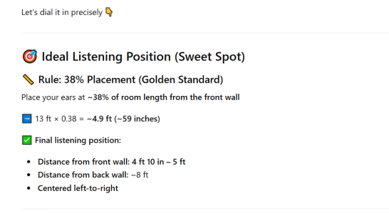

Why chatgpt is suggesting sitting position at 59 inches from front wall
As a professional designer, I trust the golden standard in my work. However, 5 feet from the front wall? 🤣 🤣 That ChatGPT suggestion is ridiculous. It's not feasible. You should check out some other authentic articles on seating positions.

This is actually the viewing distance from the TV/projector. This might be useful for you.
