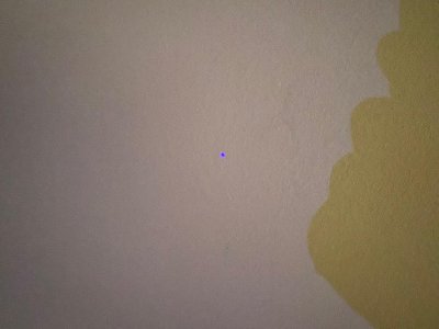

After being super happy getting my new projector, call it bad luck or whatever but my brand new Epson 9400 has a stuck blue pixel visible on black screen on the top right corner. I came to see it only when the screen was paused once on black screen and I was moving away from it. It is visible only if you stand near it directly in front. I have taken a picture of it in Dynamic color mode using my phone which increases the exposure time and hence is producing a much darker tone of blue, useful in locating the dot. The dot also shifts with lens shift and I have tried the zoom-in out test to confirm that it is indeed a hardware defect.
I have raised a ticket couple of days ago and a service center guy is supposed to visit today. Extremely disappointed by this QC job for a brand such as Epson. I will keep this thread updated.

It could be a dust particle or most likely a poloriser flaw(3LCD tech). Definitely needs immediate attention. Good that you raised a ticket 🎟️.

Yes, the service person diagnosed it as a hardware flaw and made a few calls, and told me that something called the optical engine needs to be replaced. I said I will not accept repair work on a brand new projector when it is clearly a hardware fault from the beginning. I have asked them to replace it and provide me with another projector. He said I would get a call tomorrow regarding the next steps. I don't think I will be settling without a replacement since it is a high-value purchase.

The blue dot is defective pixel in one of the the three LCD panels. This can't be repaired and hence Optical engine has to be replaced. It's the heart of the LCD projector, biggest and most expensive part AFAIK. You are EXTREMELY lucky that this happened and getting resolved in warranty period.
