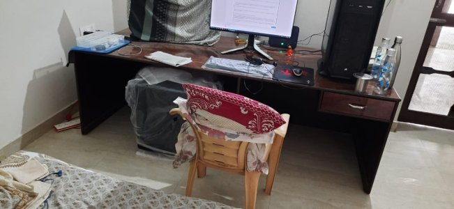

I today tried crawl again and put sub just left of where i sit . While i crawled it was good but agin only deep bass is good not other notes. I have now reset my denon to default All settings. Now coming to your answer its all new to me so apologies . If i set front to full range it may blow up my speaker if bass is too deep and where is that distribution setting?

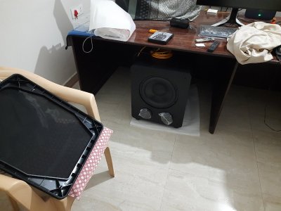

thanks a lot brother this may help . for now main issue is i cant lift this thing up alone. and i cant slide it now as installed soundpath isolation pads they may get damaged. i have reset my denon yesterday. I am waiting for my new pc table small so that i can get rid of this big table then i can try sub many places. i already downloaded sound metre app you said this before but will try. I will alo be needing help in tv mount. which wall to choose and how much the bottom of tv must be from floor

you first want me to run only dali opticon then check phase and then only woofer sperate to check sound metre
Phase between dali and woofer has to be matched, so they both need to be played together
  1. Set the subwoofer's internal low-pass filter cutoff frequency to the same value as the main speaker's bass extension.
    • For example, if the speaker’s bass extension extends down to 45 Hz (-3 dB), set the sub's LPF to 45 Hz.
