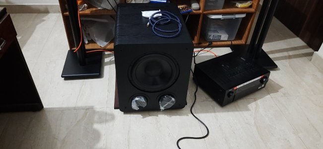

I today after resetting my denon to default . I did crawl 2nd time now the thing is i place sub wheere my chair is then i move around. Now where i find deep bass i then put the sub here but when i actually sat on chair bass is not what i heard when crawled puk should i put sub onchair to do crawl? Is it so
