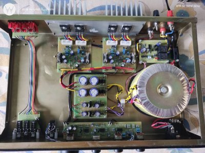

Norge concerto gold 1000 (Inside picture) in case someone like to see the circuit. I opened the lid to clean up the scratchy vol button with help of wd40. It was a total risk but worked fine and there is no scratchy sound now.
Caution - In case anyone use this WD40 product please do at own risk and great care otherwise there are proper contact point cleaners available online.
Don't worry , no risk at all! But Wd40 is not meant for cleaning pots (I have seen tech. using it on pots), but can be used for cleaning contacts and switches
Nice of you to post pics.
Actually I wanted to have a look of the PCB track side(PCB layout), for studying this circuit (which is based on Rod Elliot's P3A design). I know, its too difficult for you. I searched internet , but couldn't find it. Maybe some other member who has some technical expertise or needs to repair their amp can post it, that would be very helpful for me .
Well, it was not difficult to open the lid and clean the knob but I was just little doubtful on using WD40. Now as you have cleared there is no problem to use WD40 on contacts & switches I am cleared on my left over doubts. As such I keep doing some non technical maintenance work for my audio unit and many other small maintenance work at home, it builds that confidence and expertise to solve problems and save some bucks. Moreover it helps to learn. Thanks for your inputs.
