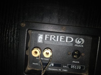

Just picked up a pair of old speakers.
Both speakers work, but the left one has a slightly muffled sound. What gives?
So, have tested out by exchanging the wires – I.e by switching L&R wires on the Amplifier. Making one speaker the L, which was earlier R, and vice versa.
One speaker , speaker X, is definitely voicing EVERYTHING with lesser volume and strength as compared to the other speaker in the Pair. Tweeter is working, but plays fainter. Midwoofer is working, but again fainter. Thus both the tweeter and midwoofer of speaker X are playing fainting as compared to the other of the Pair
Small mid 12*15 ft room. Fried Signature A/6 picked up from forum member MGDelhi. Amplifier Harman Kardon AVR 240 in 2.1 mode with a subwoofer. Nothing wrong with the Amp otherwise, nor the source of music.
I can't see the full picture. But it looks like you have to remove 6 screws to remove the panel, after which we will be able to see the crossover inside. If you have soldering skills, you could interchange the crossover between the two speakers and see of the softness shifts to the other speaker. If you don't want to exchange the crossover, a LCR meter will be able test the value of the capacitors in both the crossovers. It is unlikely the inductors to change values unless there is some severe oxidation of the coils. Capacitors definitely deterioate over time if they have any kind of oil or electrolyte inside them.

You need to purchase them. If your question is where to purchase them from, then, there are many online and brick & mortar stores where you can purchase them from. Once you extract the crossover and can read the component values, you will be able to move ahead.
The crossover MAY not be accessible after you remove the binding post plate and it's possible that you may have to remove the driver/s to extract the crossover.
Edit: At the binding posts of the speakers, why does it say "Amplifier Input"? Has this got some sort of active circuitry inside?
Yes. Active circuitry. That's what the Mars system seems like being.
That makes trouble shooting taller call. An amp expert needed.
Okay. Mars system though can be engaged and disengaged. If there's a simpler thing like some switch which turns on and off the circuit it may be doable. But either way it will be done at leisure.
MARS system details: Now tell me if its ACTIVE or PASSIVE??

m.a.r.s.® CONNECTION:
The m.a.r.s.® technology requires a two-conductor interconnect between the two loudspeakers. In order to maintain proper polarity Fried has supplied you with a twenty (20) foot cable for this purpose. The two-bladed plug on each end of the cable can only be inserted one way. If you wish to use a different cable, it is necessary to solder the plugs on the two ends so that the conductors are, in effect, crossed. In other words, one conductor should be wired to the larger blade on one end and the smaller blade on the other, and vice versa with the other conductor.
NON-m.a.r.s.® OPERATION:
Your A/6 loudspeakers may also be used in a non-m.a.r.s.® mode. Included with each loudspeaker is a short jumper cable that should be attached from the m.a.r.s.® socket to the negative (black) binding post to operate in the non-m.a.r.s.® mode. One may completely remove the knurled cap of the black binding post and place the ring connector of the jumper on the post. After replacing the cap, you are ready to conveniently switch between m.a.r.s.® and non-m.a.r.s.® modes by either using the m.a.r.s.® cable or the non-m.a.r.s.® jumpers.
m.a.r.s.® Technology - The A/6 incorporates the acclaimed monitor ambience recovery system, m.a.r.s.®. This well-received method of creating a complete stereo image and expanding the sound stage helps the A/6 in the creation of the most realistic playback possible. Unlike earlier attempts at image expansion and ambience creation, m.a.r.s.® is not an active or additive manipulation of the source material. In a m.a.r.s.® system a differential signal is passively filtered and then sent to the opposite speaker, using information available in the source material to recover a sense of the place in which it was recorded. Since the ambient information is sent to dedicated voice coils on the mid-bass driver in the opposite speaker instead of separate drivers, the image in a m.a.r.s.® system is not position sensitive. One is not forced to sit in the sweet spot to hear the benefits.
An interesting component of this version of the Vahalla sytem is the MARS system which uses a passive crossover to send out of phase "ambience information" to one of the windings of the dual voice coil drivers. This does a very good of giving a sense of the space where the recording was made. It actually does a better job of ambience retrival than using some very good surround sound systems I have tried. The effect is subtle or non-existant on some recordings, more dramatic on others. The MARS crossover was problematic in some of its earlier forms with some of the Fried speakers. The MARS version in the review Vahalla system seems to have worked out most of the problems seen in earlier versions.
The MARS series crossover design is protected by copyright laws and still being used by Van L Speakerworks.
The Fried MARS circuit requires dual voice coil drivers that use 10 ohm voice coils.
