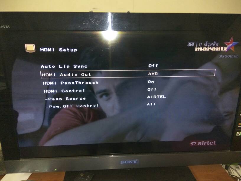

This is my settings for the HDMI in a Marantz receiver. There should be something similar in yours too.
See that option for the audio, which says AVR. I have option for TV. If I set it to Tv, then sound is sent to the TV or projector whatever is switched on. The output runs through a hdmi splitter. If I set it to AVR, like how it is, then irrespective of whats switched on, the receiver plays the audio.
Sound is sent to output only when the receiver is in stand by mode, which is due to the Pass through setting.
MaSh

Wow... what a relief you have MaSh...:)
I am literally breaking my head with audio issue... I will go home and check If i have similar setting in my AVR.
Yamaha also has that setting.

MaSh, I found the setting in my avr. When the hdmi control is off, it is giving options where the sound should come from. Thanks a lot :)
