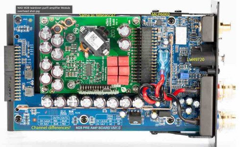

NAD uses Purifi Modules.
This is a multi channel amp, where NAD is using Purifi 1ET400A power modules. But that is mounted on a buffer board that has been designed by NAD. Even in the Purifi module, they have made some changes in terms of capacitors, etc.
Their stereo amps are complety different.
As I said before NAD is working with PuriFi.
Cheers

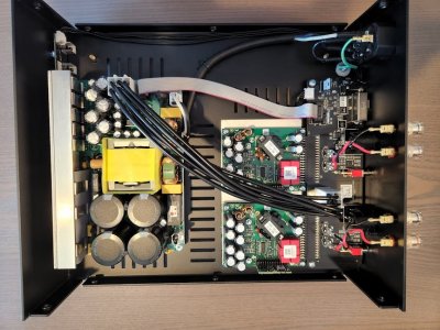

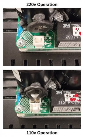

Thanks to this thread I got to learn about Purifi, it was a blind buy, initially planned to get the eval-1 from VTV and then getting the wiring redone by Rick from ASR but he suggested Dylan Launder from the same forum who is building these with custom input buffer with OPA1612/gain settings/clipping indicator. only gripe is his crazy waiting time which was 2 months in my case.
still sorting my av rack/speaker stands/power protection but from whatever little I got to listen this provides clean power
without coloring the sound in any which way.
