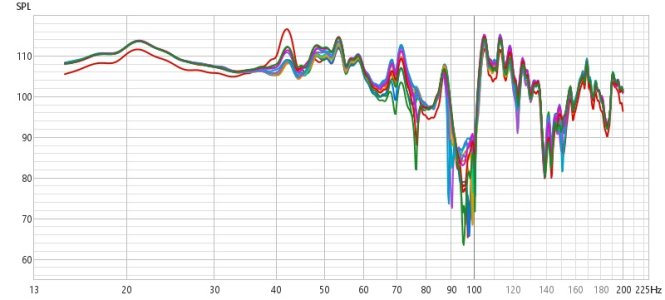

which colored line you find best? I used parametric eq to tame peak at 42hz. speaker crossover at 80hz. I tried different phases in svs app as well

I have dirac live with bass control.y room is square 11.7x10.7x10feet. I have avoided null peak areas by dividing length and width by 3 or 5. X4800h pb 2000 pro and dali opticon 2 mk2. I guess its best i can have in normal bedroom untreated.
Have you tried other positions for sub ? coz most of the dips in the graphs are your room mode as per the dimensions and svs app has done almost nothing to improve those . Regarding bass control i'd say if you take time to learn using minidsp it will be way better than dirac for bass. check youtube for tutorials.

Used svs app only to tame peaks only. That 71 to 78hz null is there everywhere in room cant treat it. Cant add another sub as can place in front only. So both wont be more than 25 to 30 inches away so not worth it
