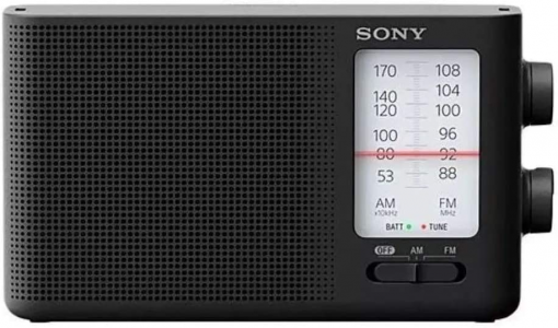

Another route I am thinking is a all-in-one DSP chip like Si4735-D60. These have I2C connection and can be controlled by RPi or Audrino. Not sure if DRM would work. Have to open up the new SONY ICF-19 I bought and check chip they have. It is a powerful radio - able to catch the waves that even my PLL radios miss.
Found a distribution with software pre-installed here. The image works in my Rpi 4
Further research reveals that the DSP chips are of different "grades" the basic ones like Si4825-A10 are suitable for "mechanical tuning" with pots and volume control. The next level like Si4735-D60 can take I2C control with any micro controller with the suitable programme in it. Those used for SDR are the "highest" level of them with DRM capabilities.
So cannibalising a radio like SONY ICF-19 (below) will not work. But this is a superb radio in itself. Able to do some MW Dxing of AIR sitting in Abu Dhabi. FM reception is great. Sound is a kind of full - characteristic of SONY Radios.
