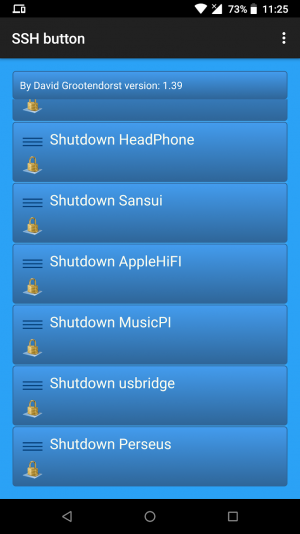

I also use an android app named 'ssh button' which allows you to create shutdown, reboot buttons for any host. I will post the screenshot in a while. So I just use the ssh button to shutdown my RPI4. Shutting down RPI4 automatically shuts down all my satellite players.
