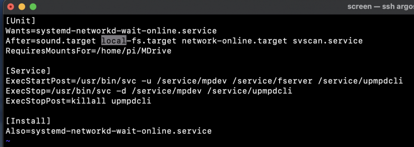

Instead of using mount.target use local-fs.target and RequiresMountsFor=disk1. You can give multiple RequireMountsFor. I think that should work. This is my /lib/systemd/system/mpd.service.d/override.conf
on one of my PIs
on one of my PIs

It has completed less than a second. What is happening is that mpd is starting faster than the fsck, even though the mount command was given before the command to start mpd.
Just use
RequiresMountsFor=/Music/HINDI
RequiresMountsFor=/Music/ENGLISH
RequiresMountsFor=/Music/REGIONAL
and any other mounts
Just use
