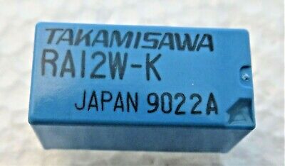

Just curious, why would you require 6 relays? Where in the amplifier are these from? If these are speaker relays you'd probably require one or two at the most. My best guess is that these are from the input selector switching. Why would the input selector relays need replacing, these almost never give trouble? Lots of questions come to mind reading your post. If you can share some info, we can help.
Note: Techs will always say 'not available' when it comes to relays. A relay is nothing but a simple electromagnetic switch. If one knows what type of relay is used and its specs, one can easily adapt other relays as substitutes. For example, when repairing amplifiers like the NAD C320 which has a single, rather poor quality OEM speaker relay, I usually go for two separate high quality relays, one for each channel as a substitute. Works perfectly

. No amplifier was every discarded because a relay is not available
